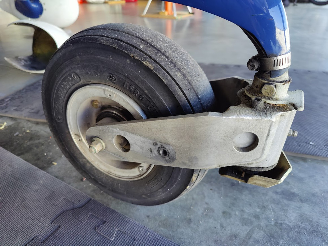

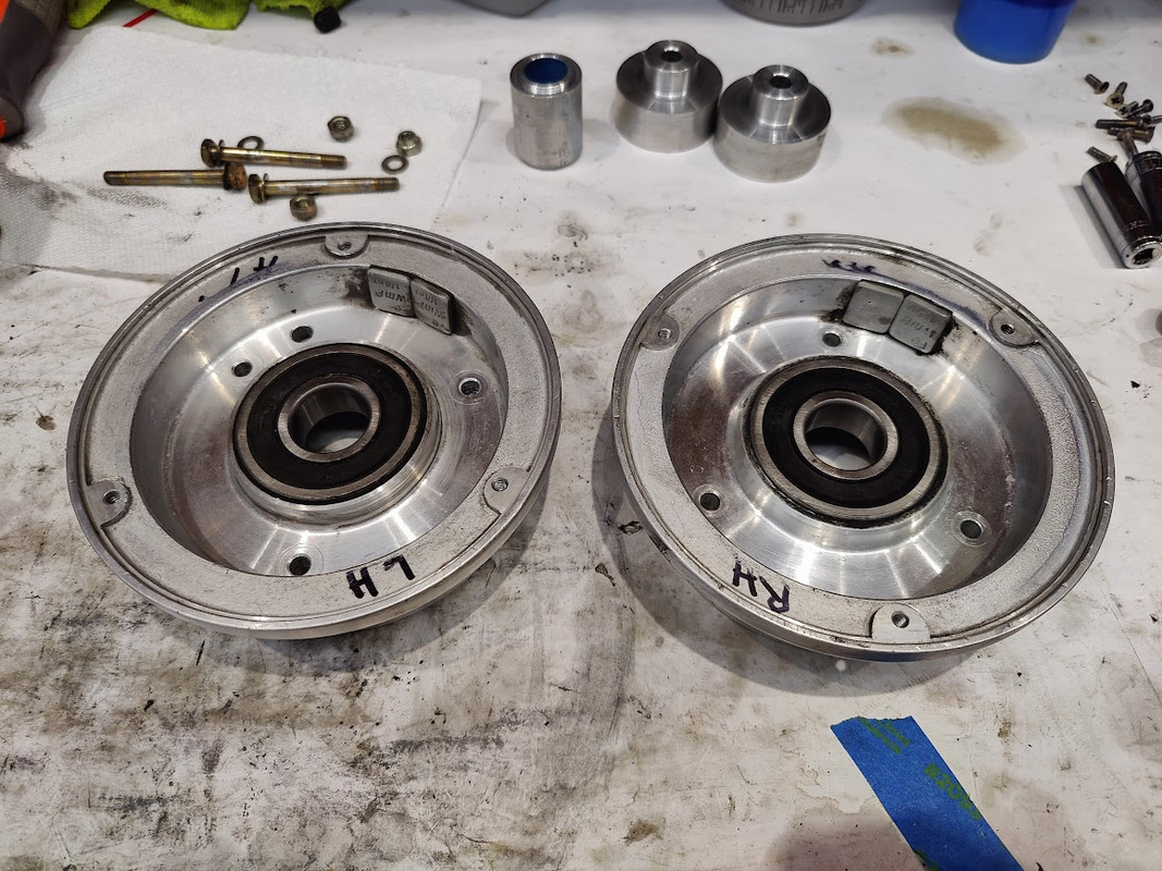

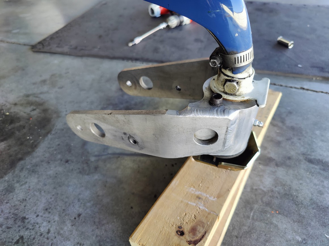

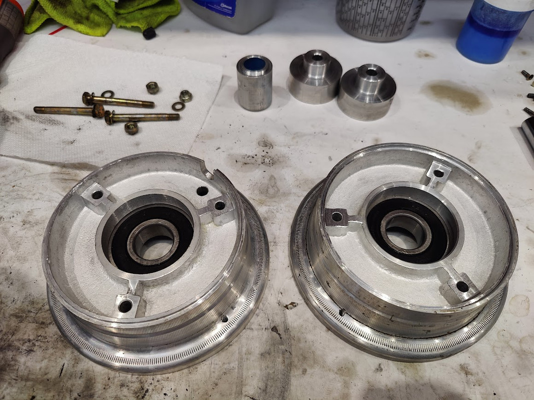

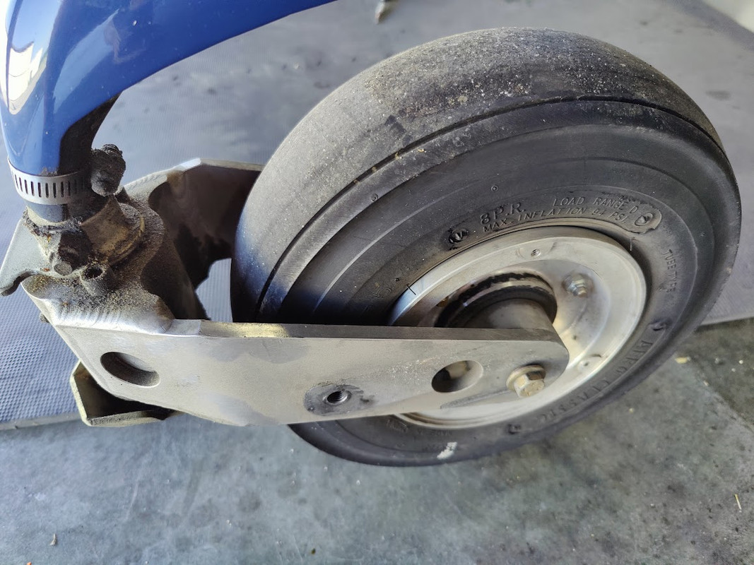

1250 hours on this arrangement. the nose wheel spins freely, and I have been happy with it. no shimmy ever. installed 10 years ago and never removed and no flat tires. the old Aero Classic tire rubber is still pliable and not cracking, so I think it's a good tire. I'll install a new tire and static balance and keep rolling. the nose fork inspection showed no areas of concern. to install the tire; insert bolt, apply nut, torque tightly and go. :)
I only land on hard surface runways with this small tire.
Posts: 1831
Re: Anti-Splat Nose Wheel - new tire install
rotation video
https://photos.app.goo.gl/WyXn3AfYt9b1823k9
adding some air while bolting this together proved to be good for not pinching the tube. a piece of cake to install a new tire.
inserting the wheel in the fork was a .002-inch spread, perfect fit. this nose wheel mod cost about $300 10 years ago. best investment I made. I'm looking for another 1250 hours.
