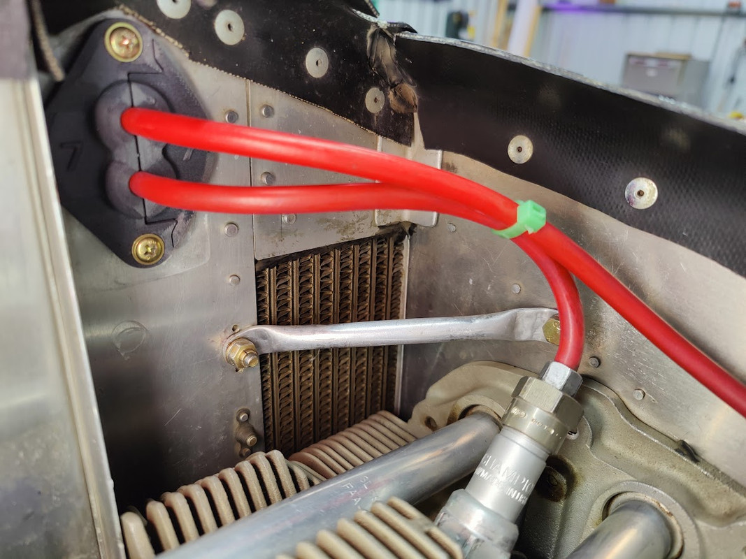

I've covered my ACOC with tape because the weather is getting cooler. I opted to cover it completely since partially taping it doesn't seem very effective. It's been a while since I removed the top cowl, so I took the opportunity to inspect the spark plug wire seals and the oil and fuel hoses I made myself last summer. Everything appeared to be in good condition, so I secured the cowl back in place.
I like the spark plug wire support I made at the oil filter. It is a better approach than hanging the support from the oil pressure sense hose.
