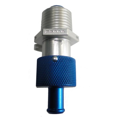

1. Oil quick drain plug can kill you. viewtopic.php?f=47&t=6262

This oil quick drain has been known to kill.
