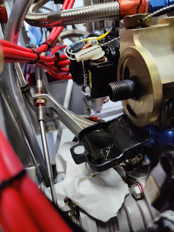

70 hours on this oil, but I decided to change it anyway because I wanted to get rid of the quick release oil drain. a long trip coming soon. quick release oil drain hit the trash can. Martin, action taken.
