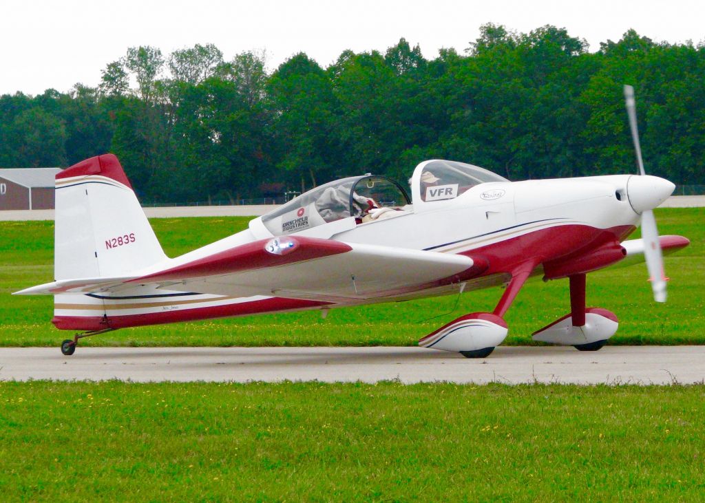

RV-7 - aircraft down - Final Report - N283S
Posts: 2285

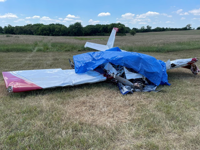

On the day of the accident, witnesses saw the airplane depart from the runway and enter a near-vertical climb before the airplane’s nose dropped and began a right turn. The airplane remained in a nose-low, near-vertical descent until it impacted a grass field off the end of the runway. Several witnesses had previously watched the pilot take off and perform various aerobatic maneuvers similar to the accident flight.
Toxicological tests detected a level of ethanol known to cause some level of impairment. The test results were also consistent with the pilot having consumed alcohol near the time of the flight. Therefore, it is likely that the pilot’s impairment contributed to the loss of control as the pilot performed an aerobatic maneuver on takeoff.
