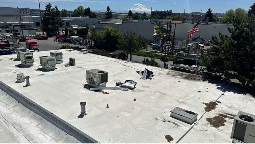

A Van's RV-12, N412JN, was destroyed when it impacted the roof of a building while on approach to Auburn Municipal Airport (S50), Auburn, Washington. The pilot was fatally injured.
Preliminary information suggests the aircraft was in the base to final phase of the approach when the pilot reported a flight control issue.

The airplane departed Auburn Municipal Airport (S50), Auburn, Washington, for what family members of the pilot reported as a routine pleasure flight. Preliminary Automatic Dependent Surveillance-Broadcast (ADS-B) data indicated that shortly after takeoff the airplane followed a southeast track, and after reaching the eastern foothills of Mt. Rainier performed a 180° right turn, and followed a similar track back to Auburn. As the airplane approached the airport from the east, the pilot reported over the common traffic advisory frequency (CTAF) that he was just over midfield and intended to perform a full stop landing on runway 35. Correlation between recorded CTAF audio and ADS-B data indicated that over the next 60 seconds, the airplane overflew the runway, while descending from 1,500 to 1,250 ft. It then began a left turn, and as it rolled out onto the left downwind leg, the pilot transmitted, “Pan Pan RV412JN, I just had a control failure, I’m inbound for 35, without any controls”. Over the next 45 seconds, the airplane began a descending left turn, that witnesses described as similar to a spin or spiral dive. A west-facing security camera, located on the exterior wall of a warehouse about ¾ miles southwest of the runway 35 threshold, captured the final 3 seconds of flight. It showed the airplane come into view at the top of the frame while in a 45° descending left turn. The airplanes roll rate rapidly increased, and the airplane struck the warehouse roof inverted in a 45° nose-down attitude. The airplane came to rest inside the reception area of the warehouse. The forward cabin sustained crush damage through to the main wing spar. The complete right, and the inboard left section of the wings remained attached to the fuselage by the main spar, and the outboard fragments of the left wing were located on the building’s roof.

While returning to the airport from a routine pleasure flight, the pilot of the experimental lightsport airplane reported a total flight control failure while maneuvering to land. Data from the onboard electronic flight instrument system and witness statements indicated that after turning from the crosswind to the downwind leg, the airplane entered an uncontrolled descending left turn consistent with a spin or spiral, culminating in a collision with a warehouse roof about 0.75 mile from the runway threshold.
