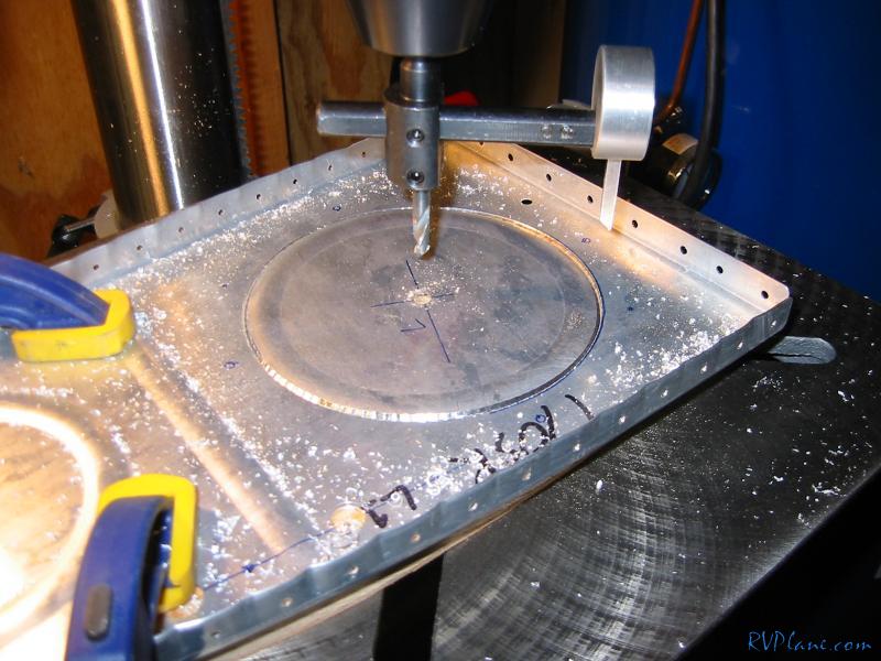

I'm at that point in my tank construction where I need to break out the fly-cutter for the first time and cut the big holes in the inboard end ribs for the reinforcing ring and the access cover plate.
I've studied the plans and drawing 16A over and over and I can't find anything that indicates how big this cutout should be. Should I just set the flycutter to cut a hole the same size as the inner diameter of the reinforcing ring? Section C-C' and section B-B' on drawing 16A seem to indicate that this cutout hole is a bit smaller in diameter than the inner diameter of the reinforcing ring, but no radius or diameter is given. Am I missing something? Is it that critical?
Any input would be greatly appreciated. Thanks!

Bottom line to your question. Yes. The inside diameter of the reinforcement ring.
Note on the plans the distance between flat flanged line on the rib and the flat edge of the access panel/reinforcement plate. Align at that point.
You want to be sure to have enough edge distance between the holes that are going to be drilled to hold the plate in place and the holeyou're about to cut.
I think I did mine the diameter of the reinforcement ring in the rib. You want to make sure that when the reinforcement ring is installed, it is flush with the web of the rib.
Here is a pic of my rib with the fly cutter:
http://rvplane.com/showthumb.php?picname=IMG_6608.JPG
And my web long entry for the task:
http://rvplane.com/?categoryid=3&dayid=211
I don't own a flycutter. I used my holesaw. It worked perfectly and I can still count to 10!
Holesaws are expensive, but I already have a good set.
I like them better than flycutters.
