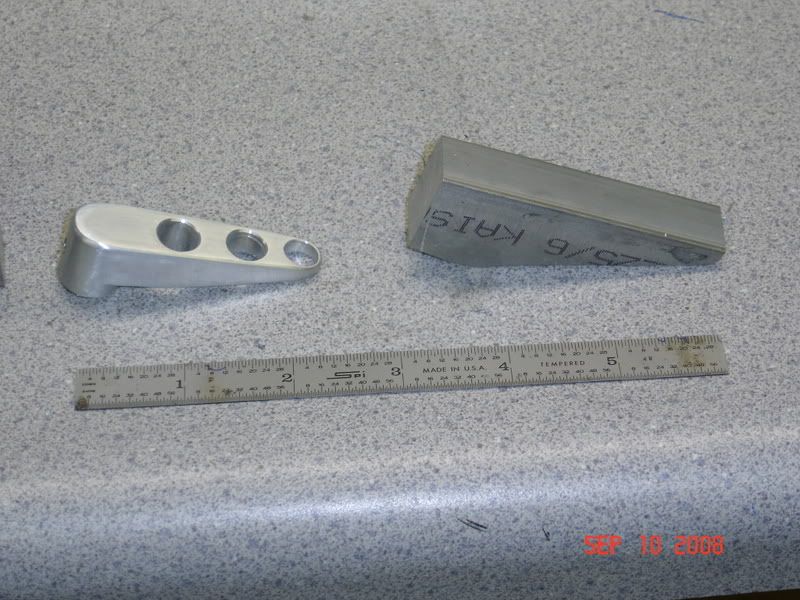

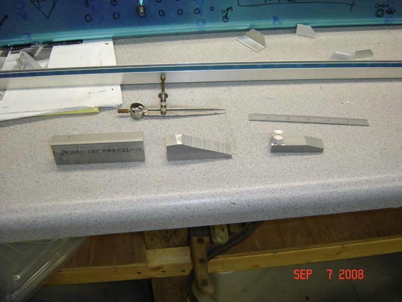

Here's the beginning 3 steps of handle #2:
I like the way this one is heading as well! ANYTHING is better than Van's version! :o

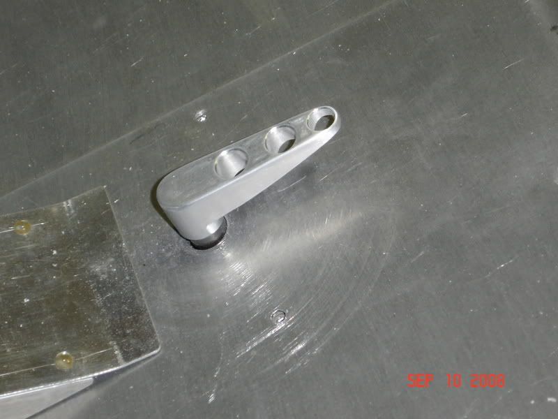

here is #2 almost finished
and installed
I like the #1 knob better, but this should function better. I may still attempt a #3 version.
I like that!
I like #1 better too, but #2 is a great looking piece, and I agree the functionality appears to be better on this one. Lookin' forward to the flight report!

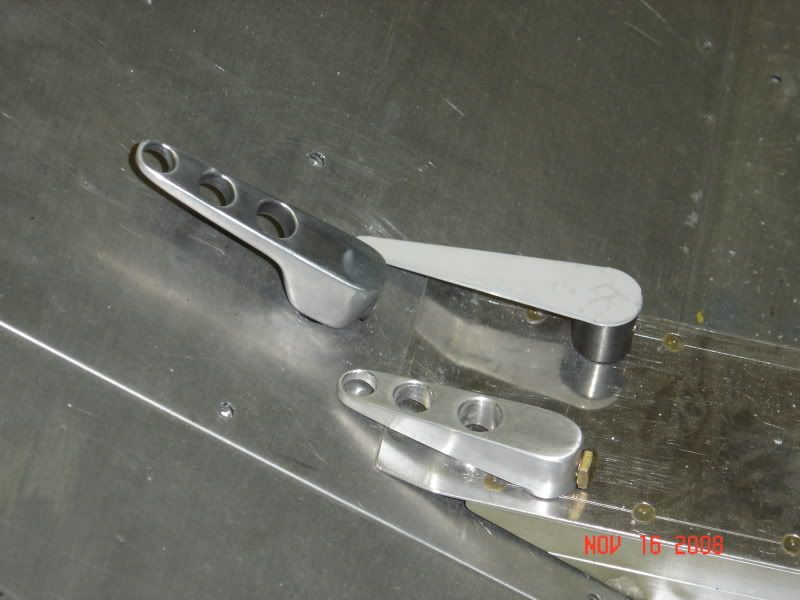

#3
Let's recap.
#1 aileron prototype was a round knob spun on the lathe. Nice except only usable during solo flight due to space between seats.
#2 was first attempt at AL lever, but I made it a touch small causing some fitment issues.
Below is #3 prototype aileron lever installed and flanked by #2 and the Vans steel lever.
I don't have the proper tooling to go into production, so nobody should be holding their breath.
