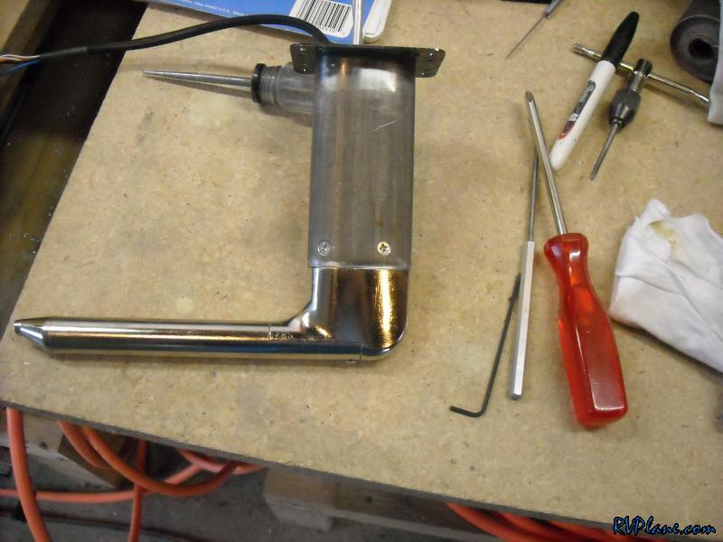

When installing the Gretz pitot mount on an RV7, what did most of you order (drilled or undrilled) I am having a hard time understanding whats drilled and what not drilled. if I order the undrilled mount, does that mean no holes in anything or is it just no holes for mounting to the spars. Thanks in advance

I am 90% sure the undrilled pitot mount does not have the holes drilled between the pitot mount and the pitot tube. That is what I bought. All of the holes to mount it to the wing/spar were already drilled.
There is also a special shallow countersunk screw used to screw the pitot to the mount. I bought 50 of these screws (min order). If you PM me your address, I will be happy to send you a handful.

I found my writeup on what screws I used and how I drilled my pitot mount to the pitot tube. If anyone would like them, please let me know. Please note you will need a 6-40 tap ($3.99 at Home Depot Online: http://www.homedepot.com/p/Gyros-6-40-T ... /204625850).

One item that has been on my list for a LONG time is drilling and tapping the pitot tube for the screws that attach it to the pitot mount. The mount came with holes already in it -- I believe their diameter was about a #18 drill bit. I bought special screws for this task. Because there isn't a lot of "meat" in the pitot mount to tap, it was suggested I go with a 6-40 screws instead of the typical 6-32. The 6-40 will give me an extra one or two threads so theoretically it will be a little more secure. Another issue with this project was I couldn't drill too deep into the pitot tube because there were the wires and pressure tubes coming out of it. I could not nick either of them.
My process for installing these screws was to first mark on the pitot tube where the holes needed to be. I used a #18 drill bit for this, rotated a couple of times to make a mark on the pitot tube. Once the holes were marked. I drilled them to a #40 with a drill stop to keep me from drilling into the wires or tubes in the pitot. I then reassembled the pitot tube with the mount and countersunk the assembly for the 6-40 screw. Once that was done. I enlarged the #40 hole to a #33 and tapped the hole for a 6-40 screw. Turned out excellent.
If anyone would like some of the 6-40 screws, let me know. I needed to buy 50 of them to meet the minimum quantity order.

#18 would be wayyyyy to big for drilling a hole getting tapped out for a #6 screw.bullojm1 wrote:I found my writeup on what screws I used and how I drilled my pitot mount to the pitot tube. If anyone would like them, please let me know. Please note you will need a 6-40 tap ($3.99 at Home Depot Online: http://www.homedepot.com/p/Gyros-6-40-T ... /204625850).
Excerpt from: http://www.rvplane.com/?categoryid=7&dayid=901One item that has been on my list for a LONG time is drilling and tapping the pitot tube for the screws that attach it to the pitot mount. The mount came with holes already in it -- I believe their diameter was about a #18 drill bit.

I totally agree - A #33 bit would be the proper pilot hole for a 6-40 tap. I think I just used a #18 drill bit to create a starting spot for the #40 drill bit. I find the large drill bits are easier to spin by hand, and they're typically sharper at the tip, making it easy to create a slight indentation in the material you want to drill. An alternative to using a punch.TomNativeNewYorker wrote:#18 would be wayyyyy to big for drilling a hole getting tapped out for a #6 screw.
