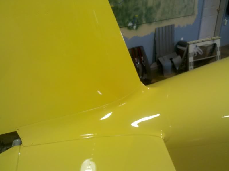

Got the Emp fairing installed today
Absolutely beautiful...WOW...

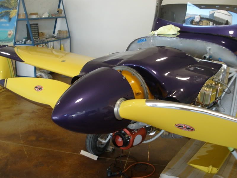

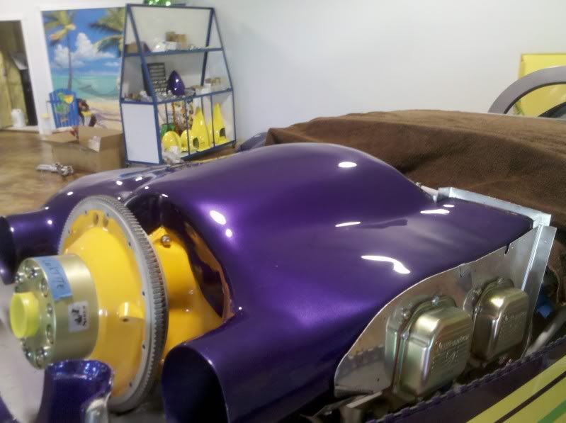

Mid week update. I got the tail group done and also closed out everything in the tail cone. Today I started on finishing up the firewall forward. I still have to make a few brackets, mount the oil cooler and 1000 other items. but fitting the plenum was cool. Remember I really had to hack it up a bunch, the other side still has some funny bumps and bulges. Then I was going to rattle can it.... Well Corky said bring it over, I have some extra purple.
Then a friend dropped by and helped me install the canopy. It looked so cool I figured I should toss on the cowl. Neither have been on since paint. I like it more everyday.

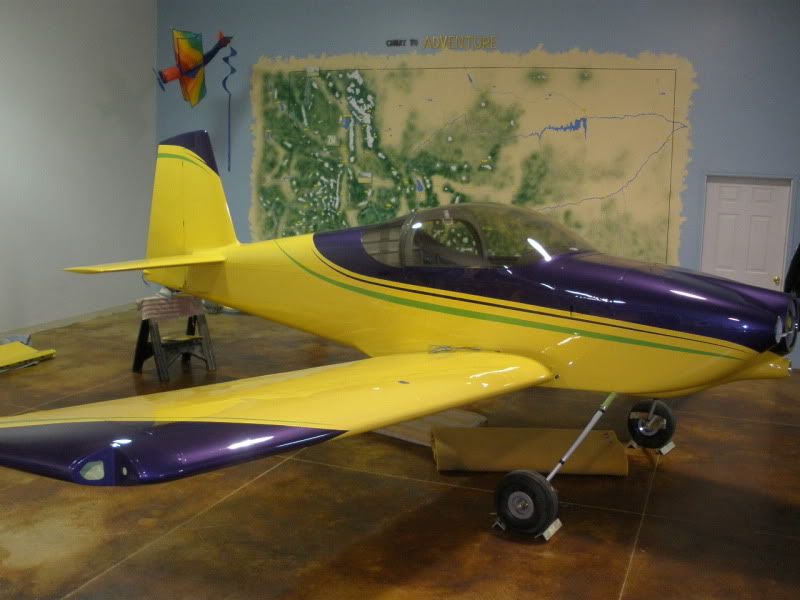

You guys are too kind. I am pretty certain I won't be winning any "lindy". Too many flaws to even be entered in the judging. My only goal has been to build a safe simple VFR fun machine for the wife and I. I added a few twists and turns(stolen from others) along the way that have come out nice. But overall my level of craftsmanship is average.

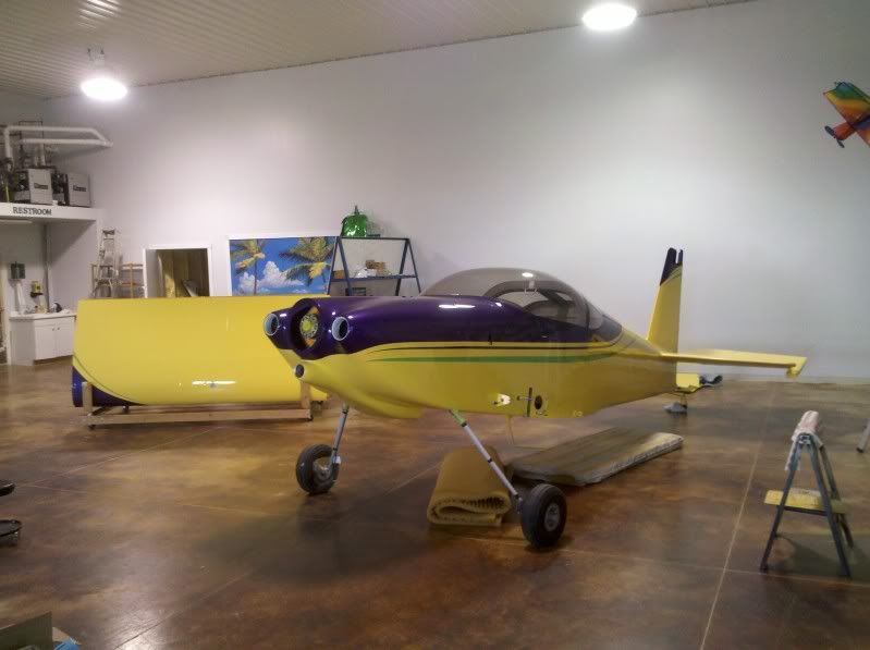

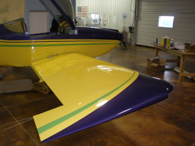

BUT it does look good! had some friends come over and we put the wings on. Spent the next 10 minutes cleaning up drool.
stuck the tips on to see how it looked. I used the Hidden hinge method to attach them(thanks Chad and Mike)

Congratulations on a great looking bird, the paint job is very sharp and will turn a lot of heads.

a very nice looking plane. You have done very well. It is good!!!!!

very very nice Brian! It looks awesome :!:

These are the shots I've been waiting to see. I'm drooling all over my keyboard here. Absolutely INCREDIBLE. I hope mine comes out half this nice.

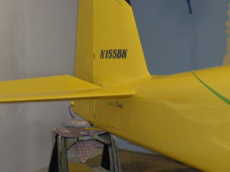

Nice man!! NICE!! I like the Nnumbers... 8)
