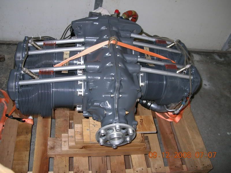

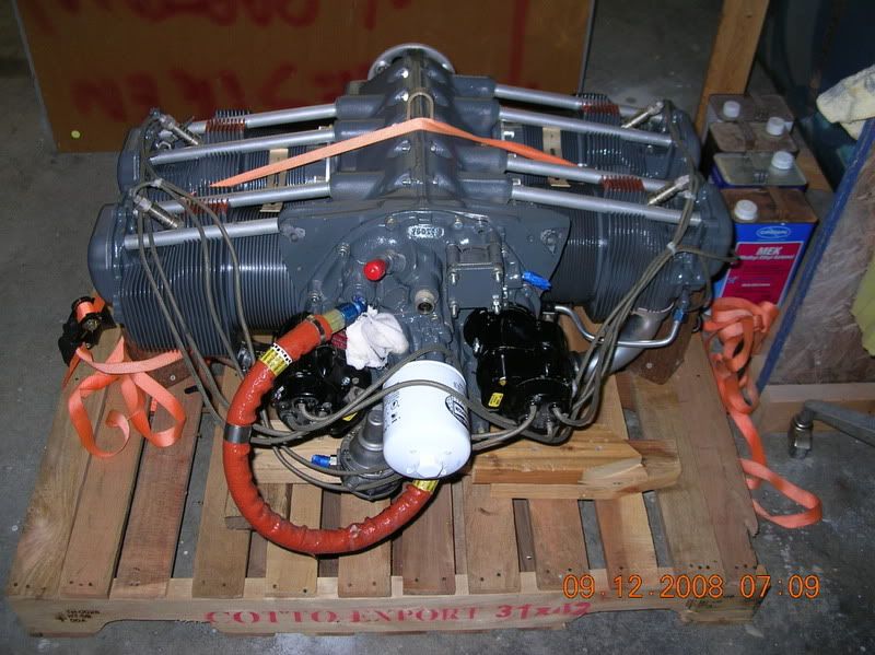

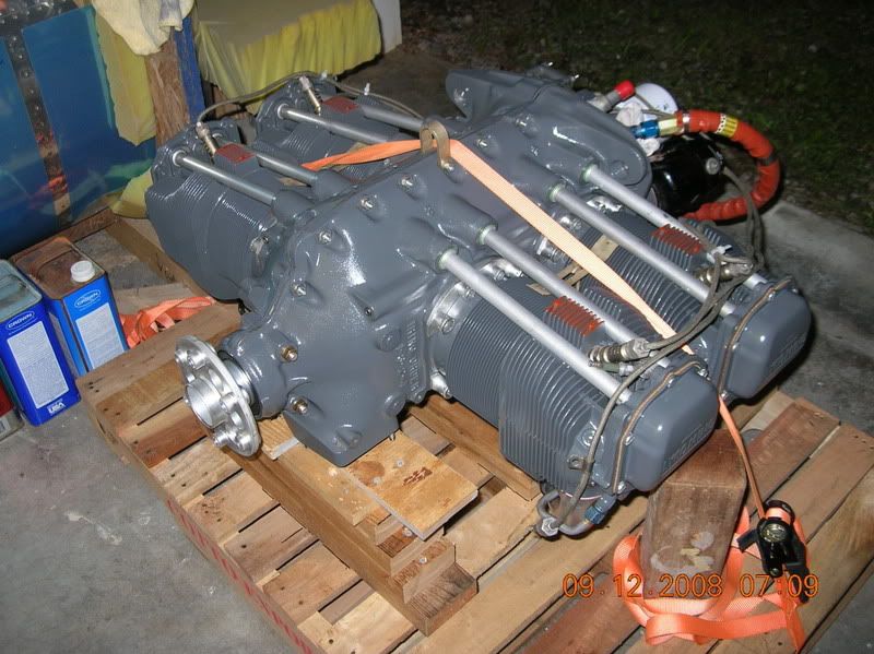

Yesterday I reached a major milestone in my build....
I PICKED UP MY ENGINE!
There is a very long story behind how I came to aquire this engine but lets suffice to say that I ended up with what I feel is a very good value for me and my airplane!
My rebuilt (new to me) engine is a O-360 Lycomming with 3.0 SMOH. The engine was recently torn down, inspected and reassembled and test ran by Don from Don's Dream Machines. Along with many new parts, many of the parts were inspected and yellow tagged by Aircraft Specialties. The crank was reconditioned, brought up to snuff on about 4 SB's including the SB505 (yes.. who knew that some cranks could be repaired to meet the SB505?), and recertified/yellow tagged by Aircraft Specialties.

Way to go! Does it have a hollow or solid crankshaft?
Posts: 1030
Thanks,
It is a hollow crank that has been repaired and coated to meet the SB505 standards.
I wanted to have a hollow crank in order to keep the options open later for a CS prop.

THAT is a very nice looking engine! I suspect you will keep it gray and not paint it to be some kind of charm bracelet bobble ehh? :wink:
Posts: 1030
For the sake of simplicity and the fact that I am artistically challenged, I will keep it grey.
Would not want to try and compete with Chad :mrgreen:
I like the drilled prop flange...did Don do that, or did it come that way? 8)
Posts: 1030
Not sure Chad,
Don originally built this engine about ten years ago. It was not run for 10 years.
Fast forward to this year, he totally disassembled it for me (I watched him do this from start to finish, less than an hour! No corrosion was found!) and rebuilt it with all yellow tagged or new parts. The crank was already that way when I aquired the engine prior to the rebuild.
He said the engine was originally built for speed and not for long life so some things were changed back to stock because I want long life/reliability and not so much interested in a couple miles per hour.
It originally had 9.5:1 pistons, stage III cam, lots of work done on a 3 angle valve job and undercut valves, etc.
It went back together with stock pistons, stock cam, reman cylinders with stock valve seats/valves, etc.
I guess all that remains of the HOTRODDING is the drilled prop flange. Seems Aircraft Specialties has no problem certifying it that way. Maybe it is a stock feature on this particular crank????

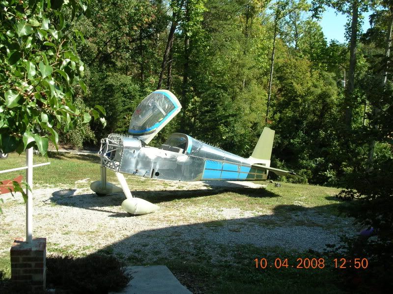

Nothing earth shattering here but since I was on vac and getting transitioned over the past couple weeks, nothing has happened with the build.
This weekend, I pulled it out so it could see the sky for the first time! Cleaned and reorganized a bit to get ready to hang that engine tonight!
That's a SWEET pic Brian!! You have a very peaceful looking build environment out your backyard. I like the pants and fairings! 8) 8) 8)
aparchment
Posts: 522
like a real airplane
Post by aparchment »
Brian that is totally awesome! With the canopy, tailfeathers and wheelpants it looks like a real airplane.
That must be very motivating.
Antony
yep, that's a great outside shot.

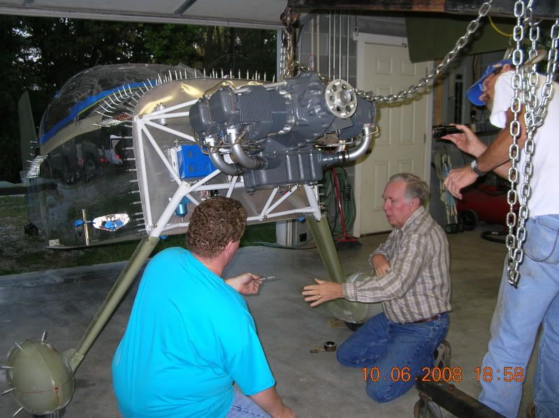

Posts: 1030
Milestone! Engine Hung!
Followed the guide to engine hanging off of the VAF site and in less than an hour start to finish, I had an engine hanging on my plane!
Thanks to my uncle, Al Swan and a local RV7A builder named Paul Bennett for their help! (Paul did not know what he was in for when he emailed me yesturday morning asking if he could drop in!) Could not have done it without them! Also thanks to Tim McGinnis and Bob Dougherty for the phone support prior to the event!
