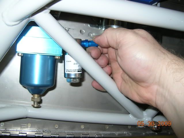

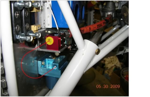

Is this plan for the fuel system forward of the FW OK?
I have my FF transducer mounted and plan on doing the following to connect it to the Gascollator. ( I will use two straight fittings and make a U shaped piece of tubing to connect it up, see the red line)
Anyone see any issues with this?
The stock hose that Van's provides in the FWF kit seems to work perfectly with this 45° fitting.
I want to connect/mount the primer solenoid on the other side of the gascollator with a steel male to male NPT fitting and a steel 1/4" to 1/8" reducing bushing.
This is all comming out pretty close to my ANL and Shunt blocks but I think it will all work out OK.
I just did basically the exact same thing Brian...except my FF transducer is mounted off the battery box...
I've had a couple of our mechanics look at it, and they agreed it's in a fine location.
8)

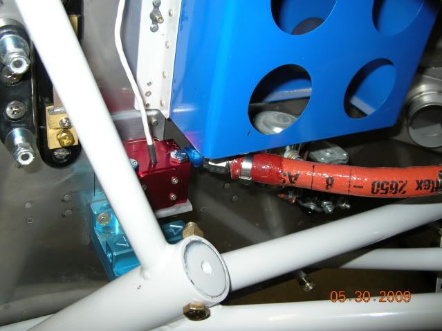

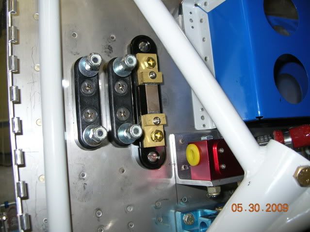

How I ended up with the FF Transducer
Earlier I went as far as completing the install using this method.....
But the more I worried about the issues I could dream up on this version like:
1. Cracking of the solid tube over time
2. Pulling fuel through the transducer creating an opportunity to suck air through a bad seal on one of the covers
3. Vapor lock in the line
4. Pulsing of the readings when the boost pump is on
The more I thought about changing it the more I could'nt leave it!
So I decided to move it! Using lots of the tips in the various threads, I came up with this option:
This option gave me an opportunity to follow most if not all of the manufacturers rules for installing this thing.
I replaced all the aluminum fittings with steel while I was at it.
I only needed one extra fuel line which I ordered from Don at Airflow Performance. He made me one up with a 45° fitting on one end and coupled with the 45° adaptor fitting in the cube, this works out great!
