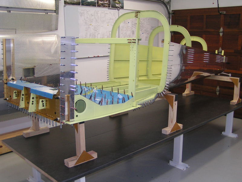

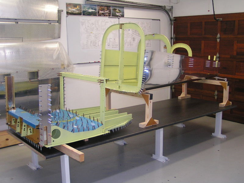

holding the front and back fuselage sections together!
I know that it is enough, but when you look at it (here are some of Rudi's pics):
...there are the upper longs, the surrounding skin rivets in the mating area and the aft baggage rib rivets!
Then you have the skins that go on top too but, it just doesn't seem like much BIG and BEEFY stuff!
Lots of little stuff combined. Strong like an ant colony, I guess!

Stressed skin ring a bell? Remember that most of the loads of the aft fuselage are carried by the skin itself. The main purpose of the internal structure is simply to hold the skin in the proper shape and keep it from buckling under compression.
Now, KNOWING that the skin takes most of the loads, and then looking at the structure and CONVINCING yourself that it really is strong enough is not necessarily the same...

Pat, yah sure... monocoque.
Stressed skin, yah... I know.
Being a "build it strong and from the middle out" kind of a thinker, it just seems odd!
It is a whole other way of thinking. I am just trying to get my head around this whole thing, as this IS my first airplane project!
Kinda different from anything else I have ever designed/built/worked on.
I KNOW that I am not the ONLY one new to this whole airplane building thing!

yeah i remeber around ten months ago joining the two halfs of the fuse,
thinking prety much the same ........
Dont worry when you have rivited in the lonegrons / side skins and then finaly rivet the aft deck this thing becomes very stong and ridgid indeed.
Just make sure when you rivet the aft deck in place that there is no twist in the fuse, because if there is it will be there for ever !!
Use a smart level staring from center section and checking all way down to the aft deck

Remeber how "rickety" the wing skeleton felt between the bench and the jig? Then you put those skins on and man...what a difference!
Faith, brother, faith ;-)

Joe, YES I DO!
It is amazing how things "firm up" when you put the skins on and then rivet it all together!
:mrgreen: CJ
