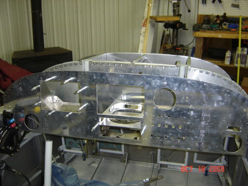

panel work
panel work
Worked on my "purchase" list for a bit today. Got shivers from all the money it's going to take, so figured some shop time was in order.
The panel is coming along. Cut the Dynon hole today

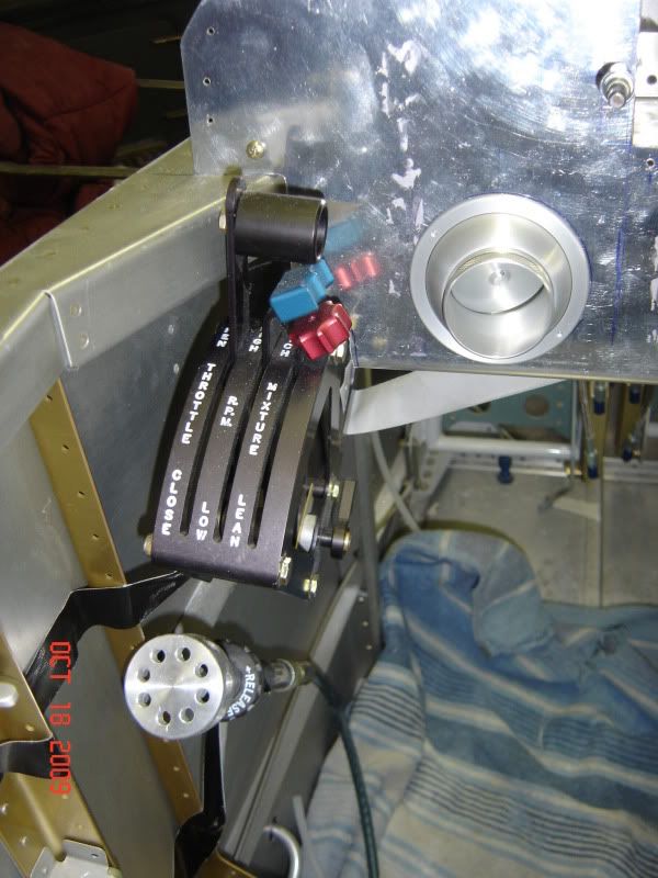

And started mocking up the left side throttle and trim
That is an interesting throttle/trim setup.
Will the trim setup interfere with yer wrist while jockeying the throttle?
-- Spike
Spike wrote:That is an interesting throttle/trim setup.
-- Spike
nope...unless I'm doing it wrong.
The trim will actually sit lower than it looks.

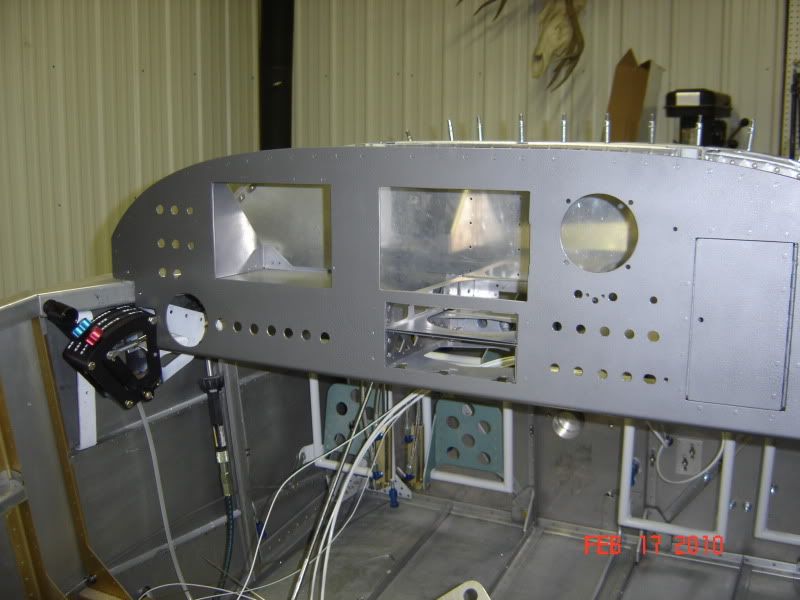

Last view with it empty.
I wasn't sure what to do with the labeling. I like the silk screen look, but finally decided on engraved vinyl for all the switches and breakers. Can't wait to start wiring.

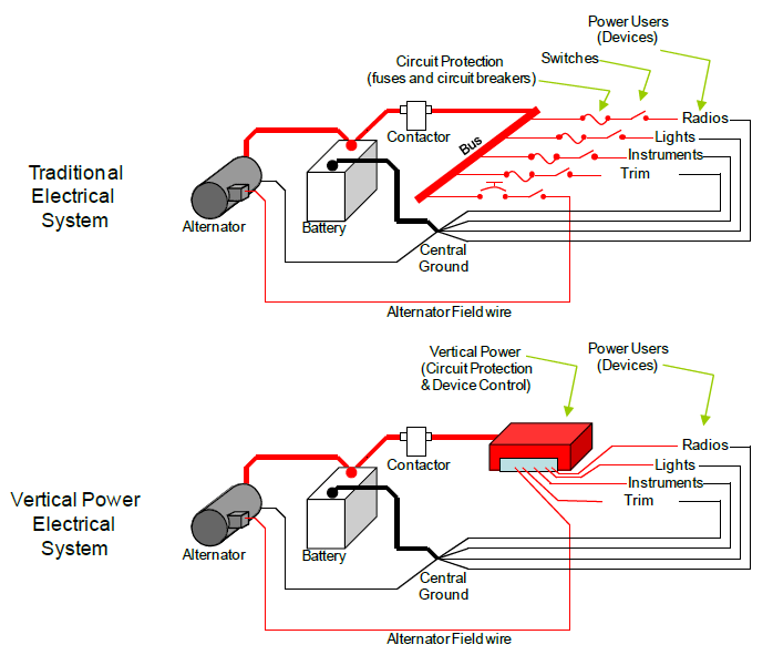

Check out this drawing:
As cool as that product is, and I love technology (I do it for a living), I still look at the VP stuff as something cool looking for a problem to solve.

In my simple mind the VP system replaces two points of failure for each circuit (fuse/breaker and switch) with breakers and switches controlled by software. For me, it's just too complex for a system that should be simple and reliable. If they really are controlling trim, as that system diagram shows...well, that would make me nervous.
But I'd be happy to be proven wrong, because it's a neat idea...

Thermos,
I don't think that it controls trim. I think it just shows the TRIM SYSTEM as a connected load.
...but I could be wrong too!
