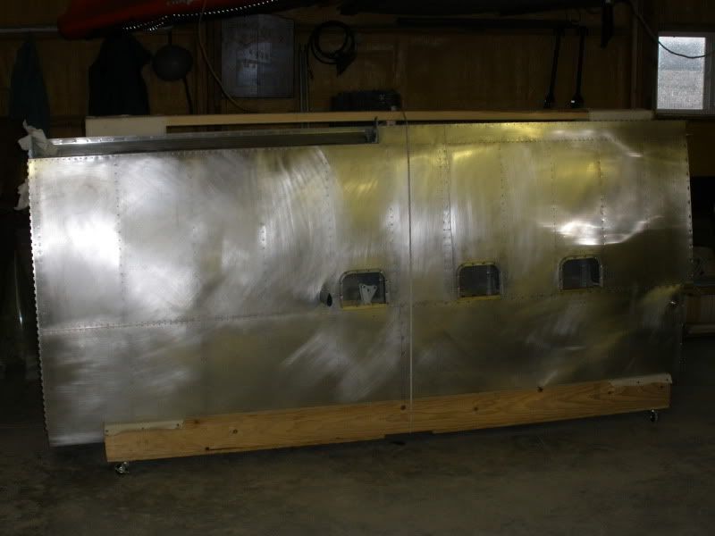

raw wing
raw wing
ok get a good look, because this is the last time you'll see these wings naked.

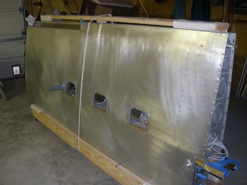

spent the last few evenings....week, finishing up the little things. today I washed , degreased, scuffed, rinsed and repeat. Off to the paint booth on thursday.
Next time I'll have them covered with paint. you'll either love it or throw-up (your choice)

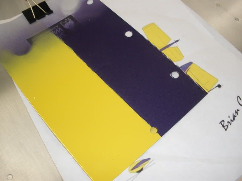

Shot a test sheet today to check color. the pic doesn't pick up the purple very good. It's brighter and more metallic in life.
Should shoot the primer later today
That sooo is going to rock dude!

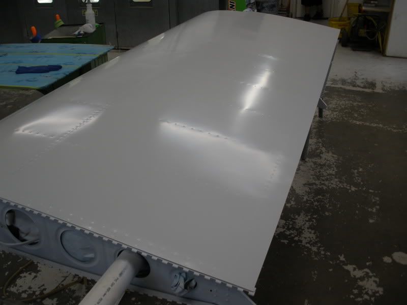

Well when it came right down to it. I decided at $200+/gal, I may as well let the Pro shoot it. I really wanted to spray, but when I saw how they came out of the booth I was thrilled. It went on perfectly.
Wing 1 with 2 coats of primer

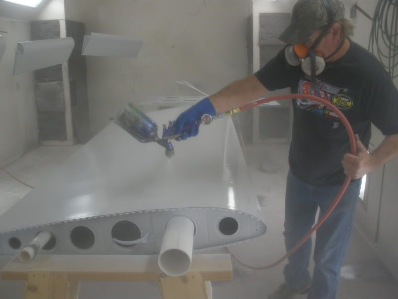

Here's my friend Corky shooting the second coat on Wing 2.
Sooo Sweet dude!
Spike wrote:Sooo Sweet dude!
yeah and that's just the primer! :yay:
What kind of paint/paint system are you using Brian?
cjensen wrote:What kind of paint/paint system are you using Brian?
PPG Omni. It's a production grade base/clear product. Not high end, but very reasonable cost, easy to apply and very good gloss. Omni AU is a direct to metal etching primer. This eliminates the chromate etch then prime of other products. This will reduce my cost and labor involved. One of the benefits is the primer is a catalyzed paint as is the base and also the clear coat. All three are a system to form a very strong durable bond.
There is more expensive and better products out there, but this will give me a great shine, affordable and durable product which should last longer than me if taken care of.
