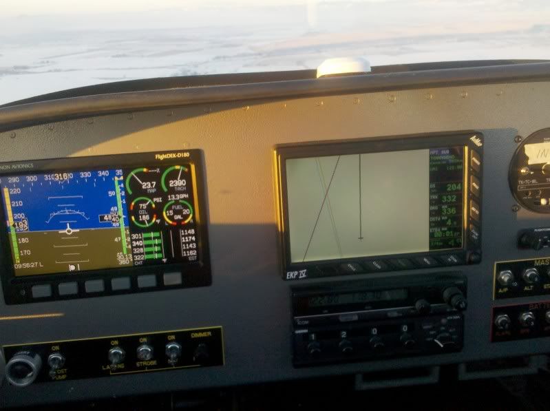

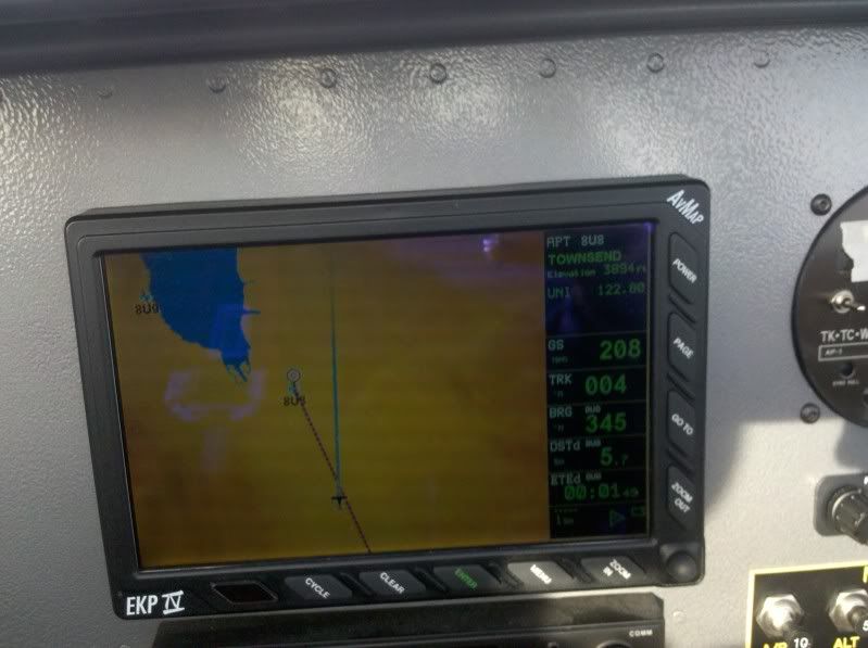

At 7500', 24" 2380 rpm I did some GS comparisons. IAS =180mph, but averaging 203mph.
I wanted to run the engine a little harder but at 2500 rpm I'm bumping into the yellow arc. This was 6500' 2500rpm.
kinda cool cruising past Mt Baldy doing 200mph in a plane built in my garage
3.9hrs so far, temps look good. oil consumption <1qt.

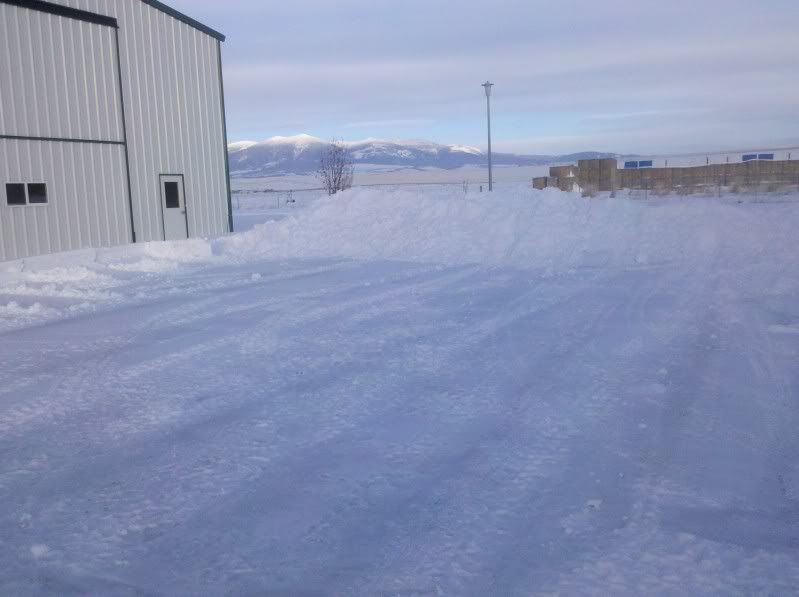

Here's a pic yesterday after some bobcat work to clear in front of the hangars.
Was going back today to finish the hand shovel work against the doors, mine is clear, but I usually shovel for the other folks.
BUT NO....our predicted slight chance of snow is actually 100% falling, 1" new and building!!!!!!!
so much for flying again today.
I'd put up with the snow without complaint for a view like that. Wow dude.
Spike wrote:I'd put up with the snow without complaint for a view like that. Wow dude.
If I had the view today I wouldn't be complaining either. problem is we have a 1000' ceiling and 3mile vis with light snow over the airport.
But yeah most days I never complain about the snow or view. Lots of people say they live in God's country...and they might, but HE vacations in Montana. :)
