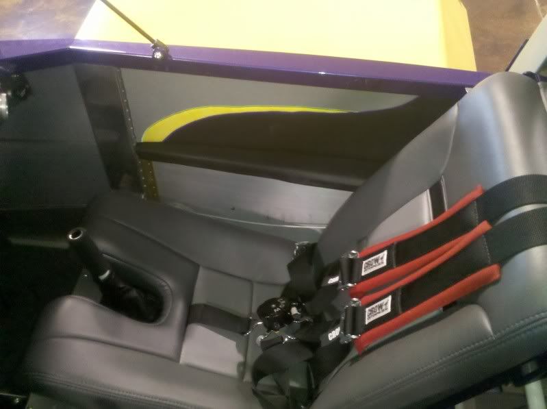

Aurora and I got invited to Montana Pilots Association meeting in Helena next week for a "show & tell" so while the exterior looks good the inside hadn't been finished. Well today Kris and I started making the interior panels. The backing is 1/4" foil bubble wrap, this is covered with a lightweight gray cloth. The panels where our arms rub have a black vinyl with a yellow accent sewed in place with green and purple thread.
yellow held down with green thread
Kris stitching down the black using purple thread
Pilot side
Pax side
I need to trim them a little smaller to remove a few puckers, then install with velcro. I'll be building arm rests covered in Black vinyl (same covering on my glareshield) and Kris will be building some pockets for the lower side panels.

I like the Classic Aero interiors, but couldn't justify the cost. So one of the best parts of this interior is we've only spend $28. Of course I still need to get materials for the baggage area and the rear floor...so another $20 or 30.

Today I made the padded armrests and fixed the fit issues. Still need to build the lower panels with pockets
Then recowled and cleaned stuff up for show and tell tomorrow.
