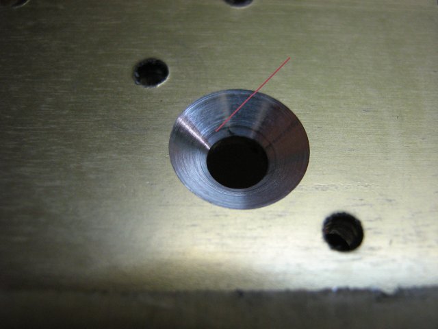

Your guess is a good one. I used a piece of angle behind the spar flange while doing the counter sinking as several others have done. If you click on the left thumb nail shot and look close, you can see how the angle got a bit of the counter sink. The bottom left end of the red line points to the interface between the spar flange and the angle used as backing.
