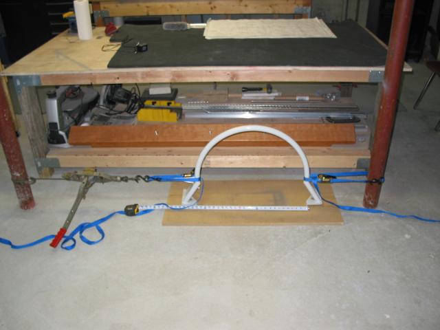

This is how I stretched my RV-8's roll bar to match my fuselage.
I had to stretch it 1/4 of an inch. To do that I had to stretch it between the poles almost 3 inches.
I first stretched it apart about 1", then relaxed and measured. Then continued to stretch it about a 1/2" more each time until I got the desired movement I wanted, which was 1/4".
Hope this helps other 8 builders.
