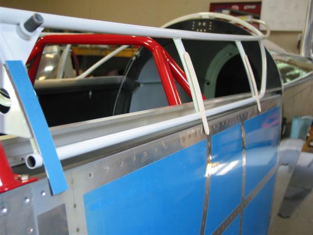

This past week and weekend, I have been working on the canopy frame and latching mechanism. I temporarily glued some wide popsicle sticks to the side frames to aid in judging alignment of the canopy frame and track rails.

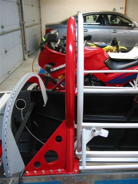

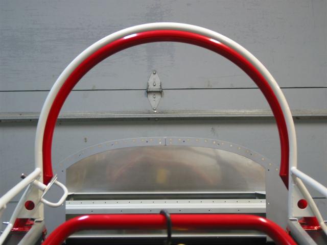

Next I adjusted the forward/aft position to align the canopy frame with the roll bar. I was able to get a nice even gap of about 1/4 inch and alignment side to side appears nicely centered.

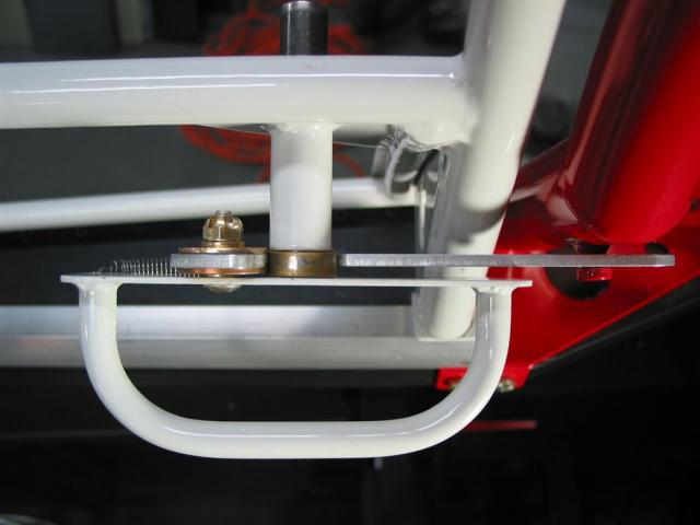

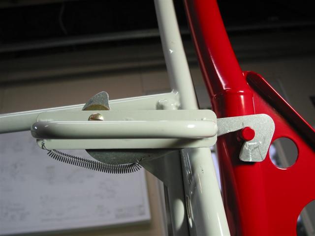

The Canopy latching assembly is a little hard to figure out at first on the plans, so I took a few pictures of mine, posted below to help other builders.
Picture Above: Top View showing the washers and cam bushing.
Pictured Above: The side view with it closed and latched. (I still need to final trim the hook area)

That looks good. I'm working on mine as well. Have you adjusted the back of the frame yet. Van's says it should be about 5/8"-3/4" above the track. Mine is about 2" right now. That is a lot of adjustment and I wonder how to do it so that it makes a smooth curve rather than a sharp bend in one location.
