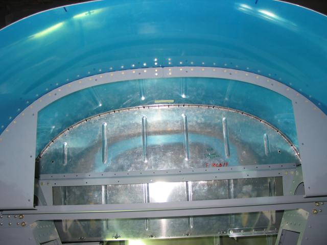

What made it easier for me was that I modified my gear towers so that the bottom 2/3 of the face plate was removable via screws instead of rivets. That made it alot easier to get your hand and bucking bar in there to rivet them.
Here's a picture showing how much access you get doing it this way.

Neat idea going with screws instead of rivets.
