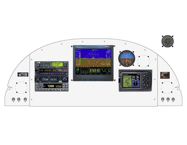

Back from FL vacation... didn't have access to Wi-Fi at the relatives house we were visiting, otherwise would have posted sooner.
Anyway, I "think" the panel drawing is close to acccurate, but it depicts the folded part as flat. So I think the drawing (even vans' dwg file) shows it FLAT before it got bent and sent. :mrgreen:
Keep in mind that this is a VFR Day/Night panel, with maybe Lite IFR pop-thru's. I probably won't even install the vertical card compass either.
I'm keeping it simple as 95% of my flying is looking out the window while formation flying, or doing some Acro or a trip with the wifey or my son VFR. The panel layout was done using "X-panel" software.

wotsit?
Post by AntiGravity »
Hey Dave,
Hope you had a great vacation.
What are those on the left of your panel? Pic is a little small and I'm not familiar with the equipment to know. Looks like PMA9000EX at top and GTX-327 down below, but what is in between? (nav and/or comms, obviously, but which?)

You are correct about the intercom and transponder.
The other two are the Garmin SL30 and the iCOM A210.
I'm installing the tray and wiring for the SL30, but have yet to purchase the radio itself. I figure the A210 will be fine for the first few flights.
Things get real expensive at the panel and FWF stages, so I needed to save a little dough on the panel right now.
