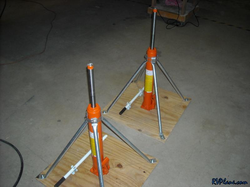

I made a set of wing jacks with Harbor Freight 3-ton jacks (p/n: 36468, $48.99ea w/o coupon), plywood, electrical metal conduit and hose clamps. They work great!
http://rvplane.com/?dayid=1015
I think I answered most of your questions?? :? :? :? If not, feel free to hit me with more!

Thanks Mike, Much appreciate the reply, and pictures on the home made jack -very cool!!
