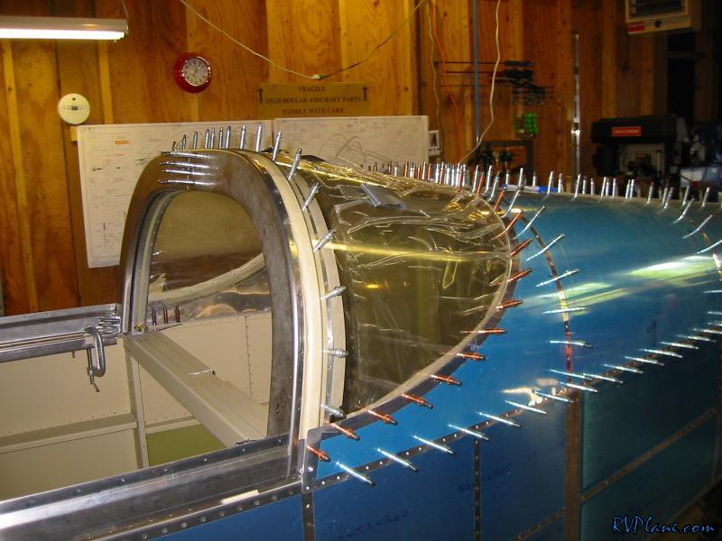

Started cutting the canopy!
Gitterdone!
That looks quite good. I just love the tip up canopies.

Mike, it looks great! Non-event is a good thing when talking about working on the canopy. Good job.

Looking good, glad it went well.

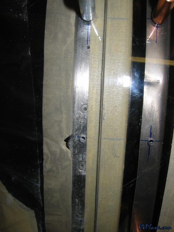

Finally finished the main choppin' and drillin' of the plexiglass today. Here is the window drilled to the fuse:
Next I spent AGES carefully trimming the windows forward edge to meet up nicely with the canopy. I got a nice 1/64 - 3/128's gap around the entire perimeter. I will make it larger once I get the canopy struts installed and see what it does to the alignment.
All I got left is some sanding, countersinking and hole enlargement.
Sweet Mike! I like how painstakingly accurate you are with your measurements. Precision will result in a BEAUTIFUL airplane!!
8) 8)
Mike, that is cool. They say that everything changes when the struts are installed.
The struts push everything apart and I hear it is very frustrating!
Let us know how yours comes together!
Looks very nice Mike. I was talking with a local 7 tip-up builder a few weeks back and he was showing me how much the struts changed things and to be prepared for it, don't get upset, it's normal.
