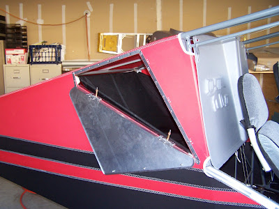

Covered the elevators this past week. That color (red? tomato? ketchup?) and black stripes is what the final colors will be.
The elevators gave me a taste of what's to come. The first one took me an entire day. The second one took me 30 minutes. They are basically like a pillow case. You disassemble the elevator tubes and then slide them in the skin. Then you reassemble the elevator tubes inside the skin and afterwards try to fish a crosspiece down through the slots into the middle to brace the front and rear spars. Luckily I won't have to do this again until I get to the flaps and ailerons, the other flight surfaces are easier to cover.

Boy Scott, that looks great! Are these envelopes already that color of red or did you paint them? Did you heat-shrink them as well?
Just like a model, once you cover everything, the project really starts to look like an airplane!

All pre-sewn and color. After stretching over the frame, you heat them to shrink the wrinkles out of it. Then clear coat to really protect the fabric and slick them up.

painless wrote:Boy Scott, that looks great! Are these envelopes already that color of red or did you paint them? Did you heat-shrink them as well?
As Brian said, they are pre-sewn, pre-colored. You pick your colors when you order the kit. One of the reasons I went with an ES model. My colors will eventually resemble this:

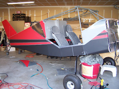

Quick update. She ain't nekkid no more.
Now just cutting holes where they need to be for things like baggage area doors and elevator pushrods and that stuff.

Wow that thing goes together fast! Nice looking too. Looking forward to hearing of engine start dude!
Dude that's AWESOME!!! LOVE the colors!!
:thumbsup: :thumbsup: :thumbsup:
That's really coming along fast, looks good Scott. Have you put more time in building this than that one set of elevators ? Bet it feels good to see so much progress.

Actually I got to this point in the same amount of time as it took me to build the entire empenage for the RV-7. It's been pretty slow going lately because of time constraints but the pace should pick up again soon.

Actually this thing is going together almost like leggos compared to the RV. I really haven't been doing all that much. It just really goes together fast.
