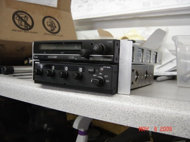

1/16" is the gap I have on my Icom 200 and Garmin320. not sure what is best. I mounted mine together and plan on only cutting one common hole.

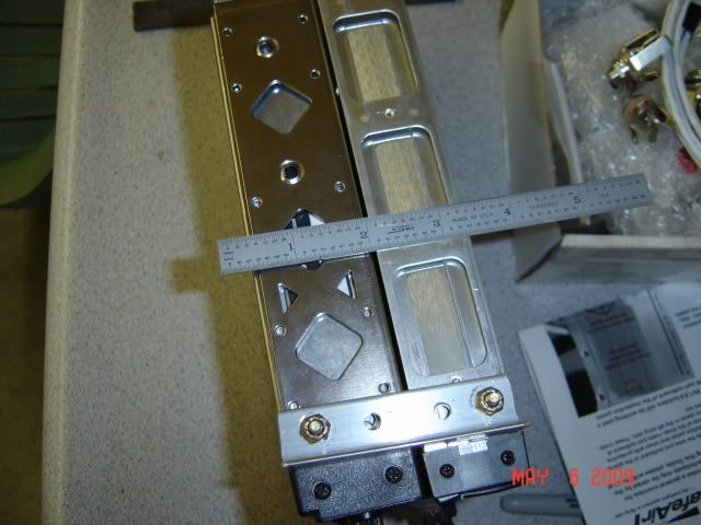

Bob, I supported the back of both my radio and transponder for my RV-6A panel. In the 6A either the transponder or ICOM radio had to be out of the instrument sub-panel. I cut a large relatively crude hole in the sub-panel. Then I rienforced the hole in the sub panel with alum angle to support both the radio tray and transponder tray. The hole in the sup-panel is high enough that I could get a second radio, a panel mount GPS and another instrument that size in it. I also made an enlarged opening in the instrument panel so that all I have to do is cut off or shorten the cover to stick in another instrument tray. I am hoping to be able to post URL to MN Wing site tomorrow or the next day with my panel in it. I sent you an e-mail today with some pictures of my airplane.
Mine is in a convenient location for a support, so this may not work for you, but this is what I did...
That bracket alone makes the tray REALLY rigid...
