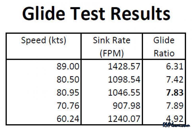

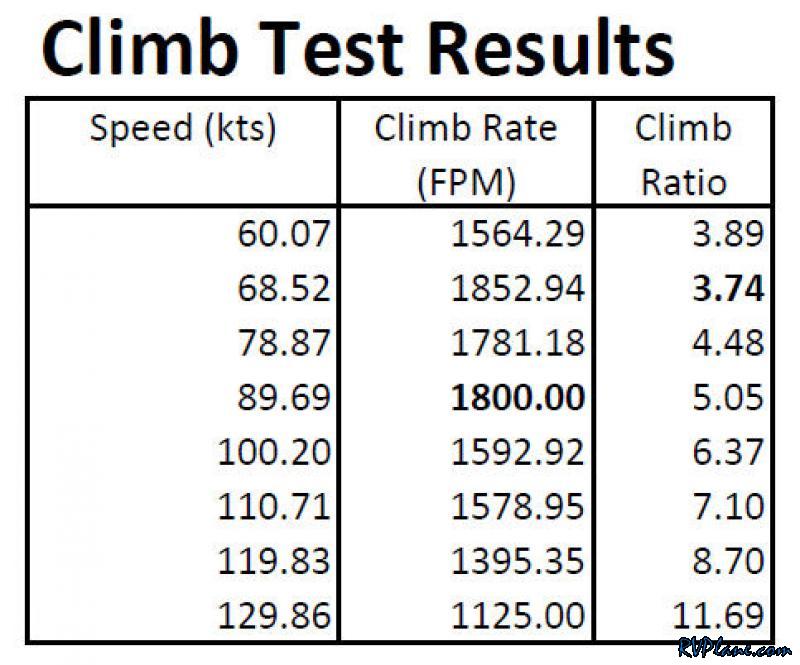

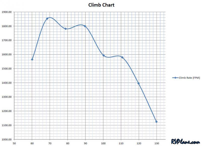

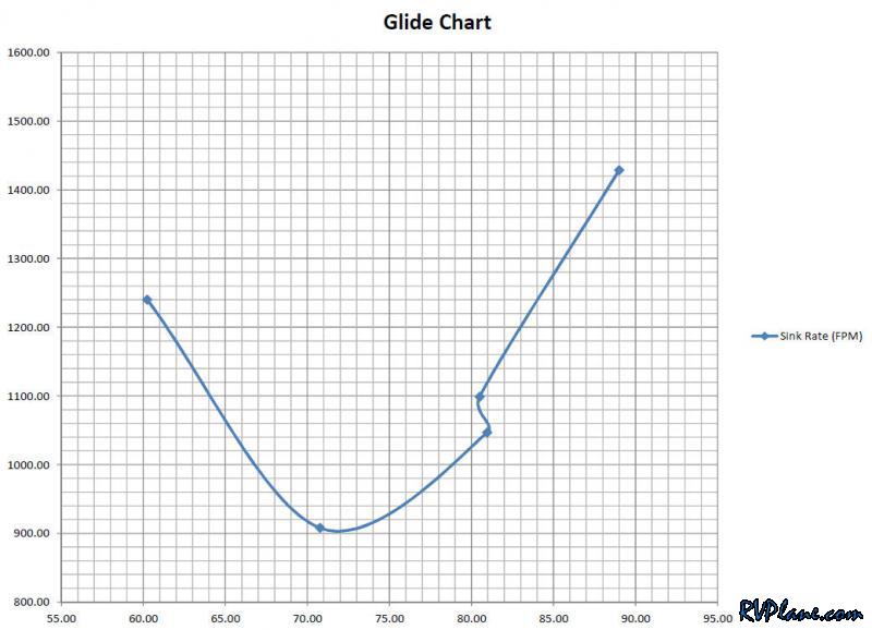

Dave,
Nice numbers. I took my logs from my GRT (1 second intervals - 3 times better than the AFS :P ) and came up with the following charts. Similiar numbers to yours. I didn't have any fairings on the landing gear, so that will definitely affect the tests somewhat.
I prettied my tests up in excel:
