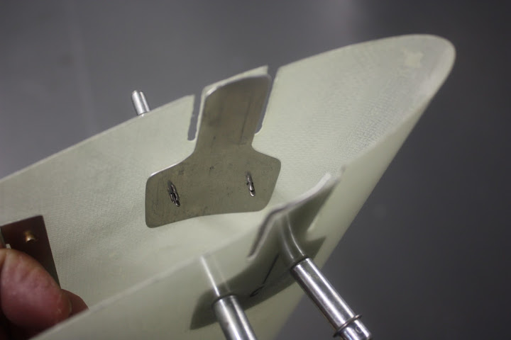

I don't recall where I found wheel pant info, BUT I will say "reinforce the fingers of the gearleg fairings" Both of mine failed. I just reglassed them this week.

I ended up putting strips of AL on my gear leg fairings. The tabs failed quickly.

This is what I did...
So far so good :)

Now there's one part that seems kind of an odd way to mount them.
