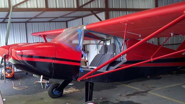

How did I miss your request Spike? Oh well, here is the update.
Everything is done except for some minor work on the cowling and painting the miscellaneous pieces. The last bit of work was to skin the wings and that is taking almost as long to do as it would applying regular fabric. These wing skins slip on over the ends of the wings like a sock and then are fastened to the root rib with screws. The root rib is then cranked inboard via two bolts and that stretches the fabric tight. Sounds easy right? Right....
And here's a picture of the plane of when I had just finished rigging the wings.
As soon as I put the wings back on and get the fuel lines hooked up we'll put gas in her and see if she wants to start up.
After that I'm calling the FSDO to schedule the airworthiness inspection.
