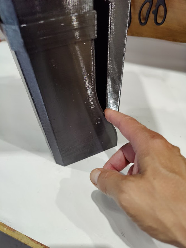

mega seatback tray ready for assembly

seatback bar storage tray... glued and assembled. instructions say wait 24hr for glue to dry so I'll do that. the fit was good, but I put a 10 lb box on top. pulling around on a single half I managed to put a small crack in one the fillets, so I added some doublers. that fillet needs to be a lot larger. this is a prototype piece for testing. the bottom flat has some oil canning so I might do something about that if this testing is positive.

seatback bar storage tray... clean up. increased the fillets on the fwd side by 10x. added a slight break in the bottom to prevent oil canning. doublers on the fwd face if needed. I don't believe they will be needed.

seatback bar storage tray... 325 grams (I originally guessed 275 grams, but I forgot to count the splice piece). prototype #2 looks good and passed the flex test before bonding. a very nice stress free fit. let it cure for 24 hrs. it has a nice soft edge. the break edge in the bottom solved the oil canning issue.

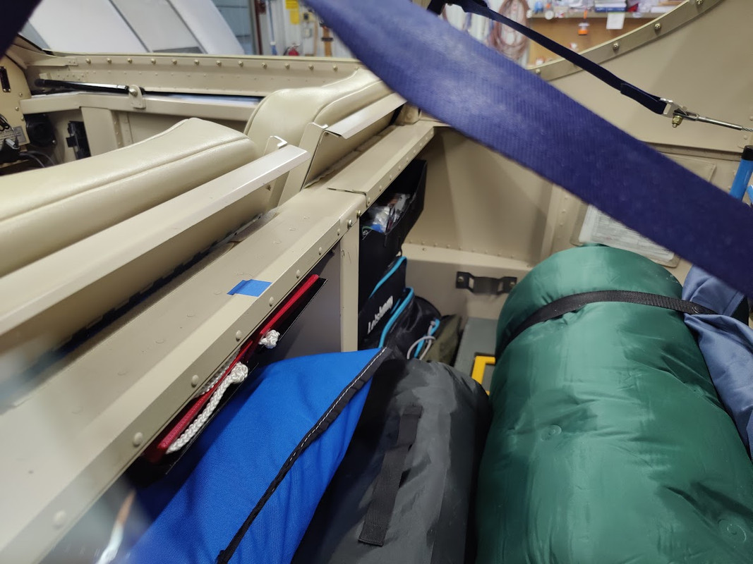

seatback bar storage tray.... now also installing to the pilot side. so, I will have two of these. I currently have the nose wheel chock on the pilot side, and it was easy access in Waukesha, even when I was loaded, so I like that. what I didn't like was that the rope for the chock is difficult to store and falls out easily. the tray on the co-pilot side is big and gave me no trouble when loaded and I even accesses stuff in flight such as my cell phone charger. I will just throw the chocks in the new tray and see if the access when climbing out is OK. attached are some assembly photos. it is a stress free fit, and everything lines up perfectly. I will have a lot of storage capacity and it will not be too far from the aircraft CG.

seatback bar storage tray.... or second cargo bay installed.

airborne again and testing these cargo bays. time to find some lead shot and increase the loading. if I put 20 lb in each, that is 40 lb total. does that count against my baggage area weight limit? :)

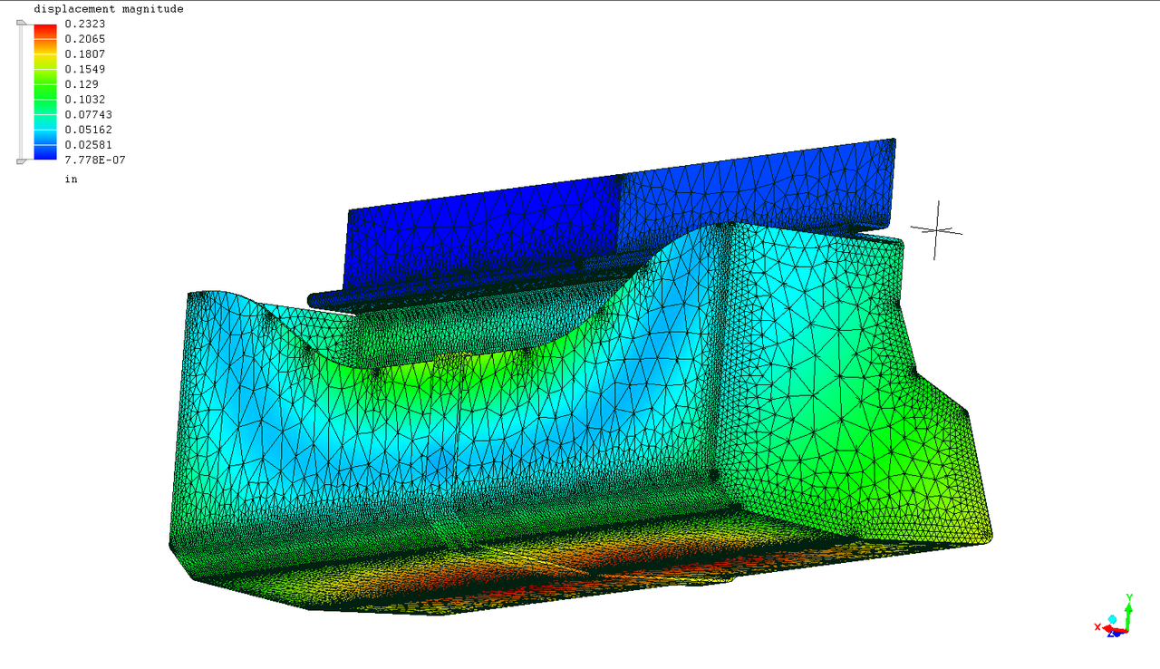

seatback storage tray..... the stresses look reasonable and within limits for an ultimate 20 lb loading. this would be when the tray is loaded with 3.3 lb and pulling 6g. the model is helpful when looking for the max stress in discrete areas. in this case the max stress is in the back corners, where the cap ends meet the vertical support. the max stress on the 3M dual lock adhesive is at the lower outside edges as seen by the reaction forces. the reaction force in the bond joints is within limits.
