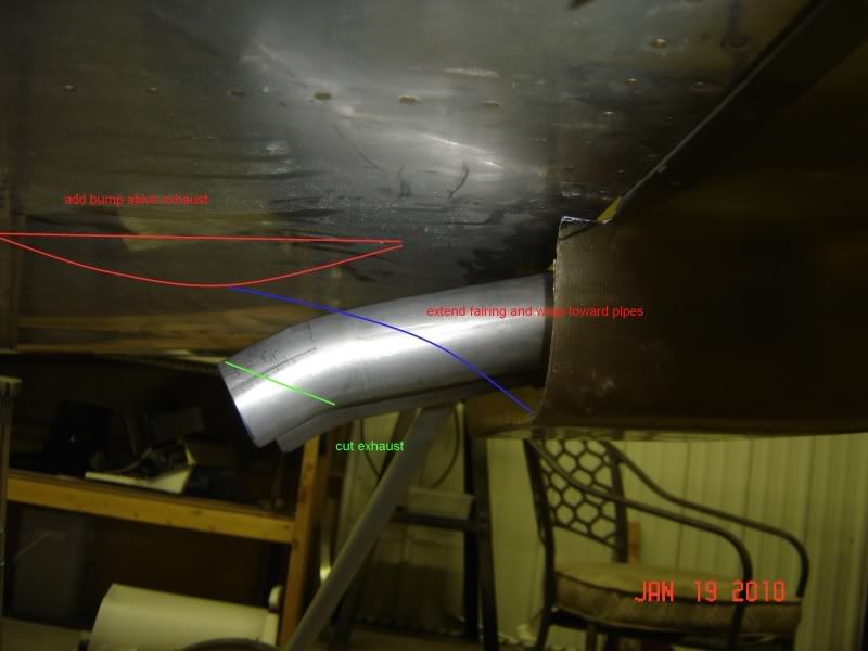

So as I fiddle with the cowl/plenum, I am looking at the inlet and outlet ratios. 33.6sq.in inlet, 37sq.in. outlet. ratio 1 to 1.1. Not bad but not ideal either. Also the square sided outlet is less then perfect as flow comes around the corners.
Well, you can't measure the true benefit of the tweak until you have data as a basis for comparison. Get it flying, get good data, then work the efficiencies.
