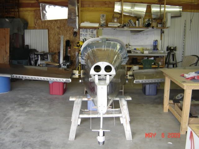

My goal is to attach the wings this weekend. My father-in-law(ex Boeing employee) will be in town, so he'll get a kick out of helping. In prep, RV-4 project owner, Mike S dropped by today to help me position the wings for the initial mating.

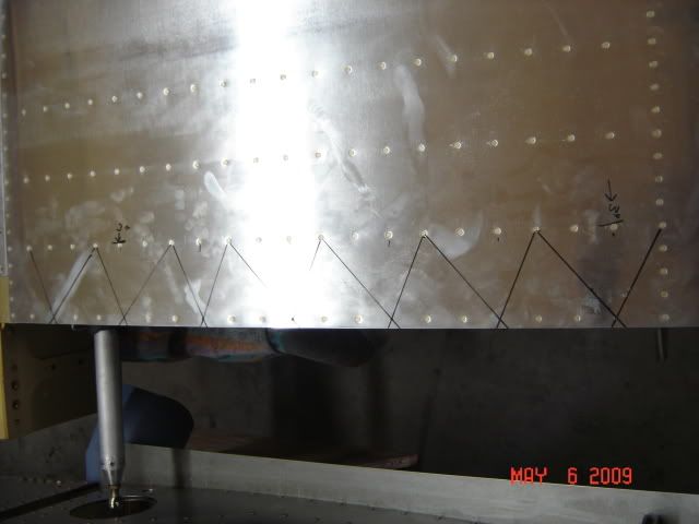

After reading Chad's build log, I made certain to layout the fairing attach holes. I used the triangular method to find centers.

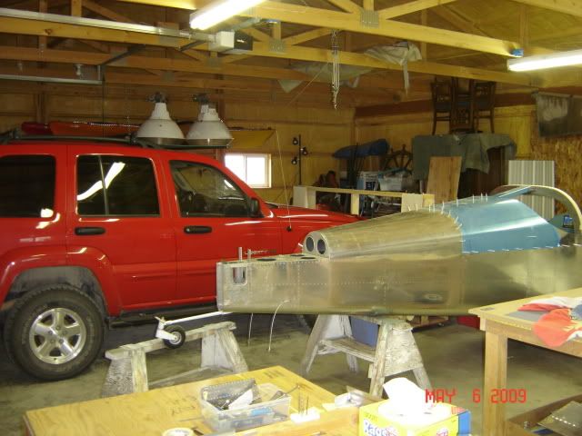

Here's some helpful numbers:
1. wing tip is approximately 6.125" higher than fuselage bottom
2. wing inboard needs to be ~.375" higher than fuse bottom
3. minimum distance needed to mate wings is 24'. Prior to spars inserted into fuse, my wing tip to wing tip is ~23'.
4. RV-7 fuse length motor mount to tailwheel is ~18'.
I was able to position everything and still park my Jeep in the shop.

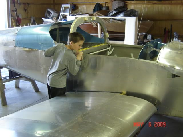

My grandson dropped by tonight. After his walk around checking out the latest progress, he said "well if we're gonna fly this thing we should get the wings on it".
So here's Austin checking clearances while I pushed the wing in place.
then I had him do the wiggle/jiggle while I inserted the pins.
Austin has been a great little helper and always wants to work on the plane when he comes over. He'll be one of the first pax.

woohoo! after checking the level of the fuse again. I checked the wing tip to tail distance and it was only off by 1/16", so figured I should check the sweep. All 4 plumb-bobs were dead nuts ON. I'll let check the incidence tomorrow.
Guess I got one of the good QB's before the factory changeover.
