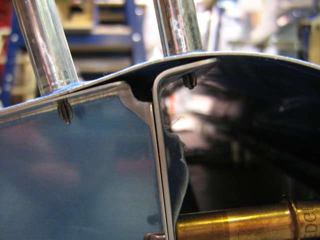

After riveting my flaps together I noticed that the top skin has a very slight raised lip as it attaches to the front spar. Is this a common thing or did I do something wrong when building it. I will try to post a pic after I import them. I still have to get used to posting pics.

Do you mean something like this ? This is after a lot of work trying to get rid of the bend aft of the spar rivet line. To my way of thinking the curve in the top skin should start just forward of the spar rivet line.
One of mine the start of the bend was way aft of the rivet line, the other was at the rivet line. I tried taking the bend out of the really bad one, gave up, and got a replacement skin. The one with the bend starting at the rivet line came out ok once the rivets were put in, clecos could not hold it flat to the spar before that though.

Your pic shows what happened to mine. Did Vans give you a new skin? or did you have to pay for it? Unifortunatly I riveted mine all together and noticed it after. I wonder if Vans would give me the parts to rebuild my entire left flap even though I would hate to do so with the work I put into it?

YesMike Balzer wrote:Did Vans give you a new skin?
Yesor did you have to pay for it?
It is actually a long story, I ended up with two replacements, the first one was even worse than the original skin, the second one was fine. With all the issues of importation, customs, brokerage fees, I ended up paying quite a bit by the time it was all over, but Vans did not charge me for at least the second skin (I don't remember about the first one), or even the shipping on the second one. I did have pictures of before and after to document the whole thing as well as to compare it to a properly bent one.
I certainly would have been hard pressed to make much of case for even a replacement skin if I hadn't taken all the before and after pictures, I doubt they would spring for a whole flap, but that's just my opinion.
If you do decide to drill out all the rivets, get a new skin, and rebuild it, I would suggest requesting that whoever picks the new skin to make sure the forward bend doesn't start aft of the spar rivet line. It seems a number of builders have decided to leave well enough alone, or haven't even taken notice, it all depends on how bad it turned out and how picky the builder is with the result.
A couple of other local builders (not building RV's) suggested just filling in the dip prior to painting, others just shook their head and said that it would be normal for their metal kit.

My flap turned out very nice besides the ski jump. If the Right Flap is the same I may just leave well enough alone and keep building.
If I find I cant get them to line up correctly or it effects the way the aircraft flies I may build new ones.

This is the great thing about this website! I was just about to start riveting the top skin to my flaps when I opened this thread. It made me stop to check out my skin.
In my case the flap skin looks to be a lot more builder friendly. This goes to show the differences in how the parts are made.
For those that are in the other camp, with bends beginning aft of the rivet line, I wonder if the wing nut type clecos would have the strength to pull the skin flat????
I don't need that much in my application but I may use them any way to pull it nice and tight.

Using the wingnut clecos won't solve the problem Mike had. In the end, the spar is made out of thicker material and will bend the skin to form the "ski jump". The only solution is to adjust the bend on the flange of the spar to match up with the skin.Cherokee Driver wrote: For those that are in the other camp, with bends beginning aft of the rivet line, I wonder if the wing nut type clecos would have the strength to pull the skin flat????![]()

wingnut clecos may get you what you need or possibly not. one thing though is that if you crank down on the nuts too hard and the material is pretty thin (which it appears so in the pic) they may have the tendency to stretch the hole a bit and the wing nut cleco to pul through the enlarged hole.
nice thick 3/32" diameter washers on the back side usually helps from having them pull through the hole and blowing it out.
If you already have the wing clecos, try them out and see what it looks like, but if you dont have them, it could be an expensive deal buying them at over 2 bucks a pop new.
I use them a lot on repairs on aging aircraft, so I made the investment on a small collection of different sizes except 3/32" because they arent common in my line of work.
e-bay is usually a pretty good source of clecos (wing and button type), you just have to know the prices and dont overbid. people pay more for clecos on ebay than if they would have bought them from any of the aircraft tool stores online such as yardstore.com and browntool.com

I tried the wingnut clecos before giving up, mine was really bad at the beginning as I said, didn't do the trick.
I use a 6-32 nut on the back side of the wingnut cleco or a washer and nut sometimes, it is not that difficult to pull right through otherwise if using a wrench. I've only used them in few places where I just didn't want to take things apart again. They were handy, but like most really special tools, there are other ways to get the job done.

Toms right,
wing nut or draw clecos are primarly made for thicker materials, I used them alot in the airlines when you put a special sealant between the parts you are riveting to make sure the part you are riveting stays firmly seated before the sealant cures. The sealant was 1436 corrosion inhibiting sealant used in certain areas of a jumbo jet.
