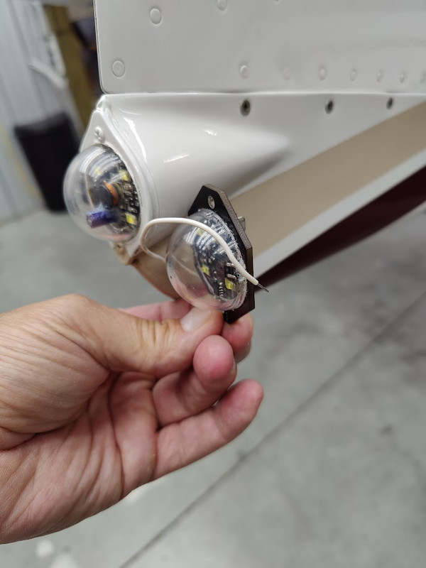

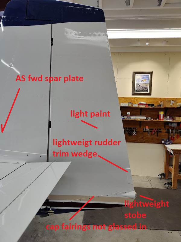

during the testing my feet were firmly on the rudder pedals, not that it would have mattered much if the rudder had decided to flutter.
I believe the biggest consideration for rudder flutter is rudder weight, especially at the trailing edge. to increase rudder flutter margin, keep the rudder as lightweight as possible. you may even consider not painting it at all.
rudder strobe weight = 18 grams.

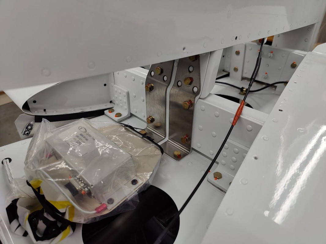

I don't believe the Anti-splat fwd spar plate does anything for rudder flutter. my reasoning for adding the plate is because I didn't like the bolt slots used the attach the rudder fwd spar to the horizonal spar and for bird strike. who knows if this is reasonable thinking, but it's added.
