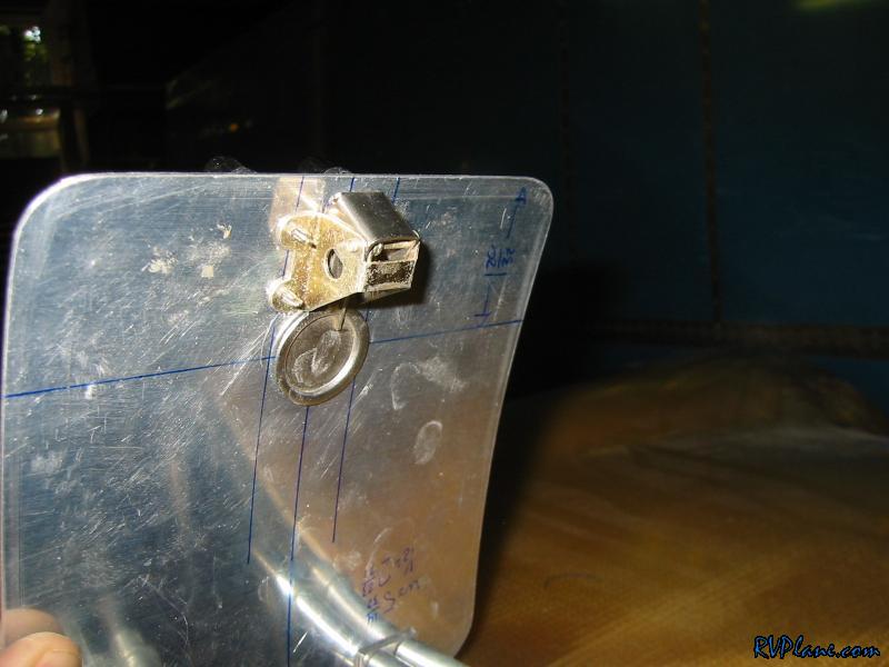

So I was playing around with the Hartwell latch over the weekend and I don't really like it. When you open it, it springs open with a hell of a force. It snapped my fingers pretty good on a number of occasions. So today I was hunting around for a new solution and I stumbles across the KM610-64 latch. This simply just requires a round hole in the oil door. Here is a pic of how the finished product looks:
I found a great deal on them at B&B Aircraft Supplies (913-884-5930) - $5 per latch! The lady who I spoke with at B&B was very nice and get this -- they send me the part, and when I get it, I send them the check! I have never run into a business who has ever done this! They have a $10 minimum purchase.
The only downside I could find about these latches is they tend to "eat" away at the aluminum/fiberglass they latch onto. Someone recommended a great solution of using a strip of stainless steel for it to latch onto.
I will report my findings once I get the latch installed. I will have an extra latch available to anyone who wants it for the pro-rated cost.

I'd rather have that style, too, after playing a bit with the Hartwell type in my baggage compartment mod. I will be happy to buy that one - you can just throw it in with the hinges to me and Chad.

Sure, once I get it mounted up and tested I will toss it in the same package the hinges are in.

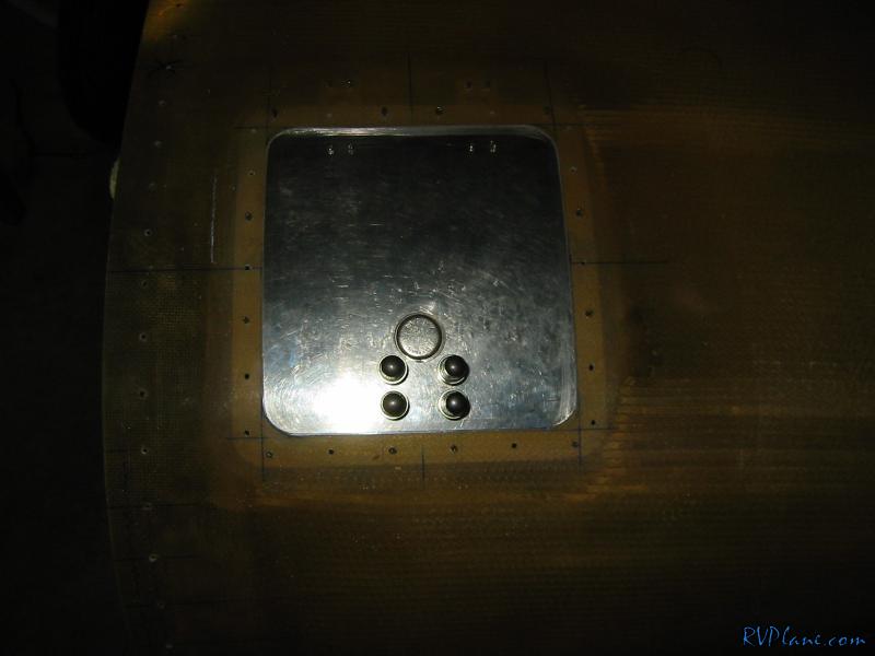

OK, the oil door project is finished (except riveting). It turned out great!
The round camlocks work really nicely. Carl and Chad - I will send you guys out the hinges and camlock this week.
