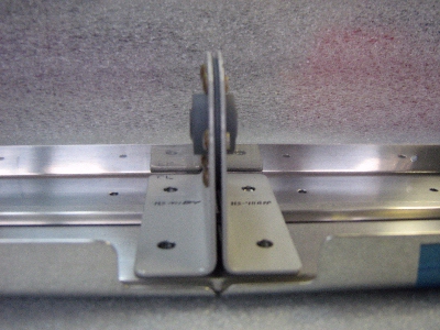

Already have gotten cranking on the HS! Spar doublers are shaped and prepped, and clecoed into the spar channels. Tomorrow night, drilling! :D

Good deal Ian!! It is awfully exciting to get started! Don't worry, as progress comes, so does MORE excitment!! 8)
OH! Don't forget to post that picture of the first rivets set on the center bearing!! :wink:
Congrats on getting started Ian. One hint I can give for the HS is read the notes on the drawing, not just the instruction sheets, there is at least one operation not in the instructions that is a whole lot easier to do before those two bars are rivetted in place. The little cut-outs in the bottom flange of each spar is what I mean.
Another hint, mark a line on the forward spar flange pieces before you drill them using the skin as a template, and make sure that line shows through the holes in the skin.
Last hint, read ahead and test measure a LOT before doing the holes and cutting of those 404/405 pieces where they join the forward spar and stiffeners.

Thanks for the tips, Don! I''ll have to wait til I get home and dive back into the plans before all of what you just said really sinks in.
